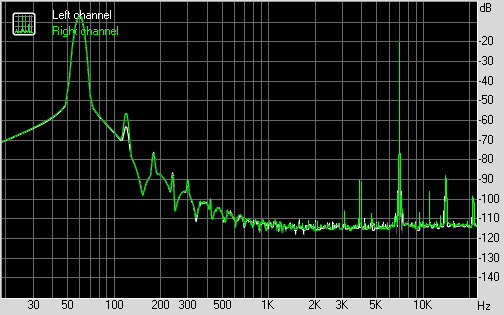

| Testing device | HTC Desire |
| Sampling mode | 16-bit, 44 kHz |
| Interface | |
| Testing chain | External loopback (line-out - line-in) |
| RMAA Version | 6.2.3 |
| 20 Hz - 20 kHz filter | ON |
| Normalize amplitude | ON |
| Level change | -11.4 dB / -11.2 dB |
| Mono mode | OFF |
| Calibration singal, Hz | 1000 |
| Polarity | correct/correct |
| Frequency response (from 40 Hz to 15 kHz), dB | +1.43, -0.85 | Average |
| Noise level, dB (A) | -83.9 | Good |
| Dynamic range, dB (A) | 83.8 | Good |
| THD, % | 0.031 | Good |
| THD + Noise, dB (A) | -66.4 | Average |
| IMD + Noise, % | 0.213 | Average |
| Stereo crosstalk, dB | -65.5 | Good |
| IMD at 10 kHz, % | 0.064 | Good |
| General performance | Good |
| From 20 Hz to 20 kHz, dB | -2.54, +1.43 |
| From 40 Hz to 15 kHz, dB | -0.85, +1.43 |

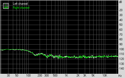

| RMS power, dB | -79.7 | -79.5 |
| RMS power (A-weighted), dB | -83.9 | -83.8 |
| Peak level, dB FS | -59.6 | -59.6 |
| DC offset, % | -0.0 | -0.0 |
| Left | Right | |
| Dynamic range, dB | +78.4 | +78.4 |
| Dynamic range (A-weighted), dB | +83.7 | +83.8 |
| DC offset, % | -0.00 | -0.00 |

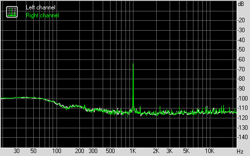

| Left | Right | |
| THD, % | +0.0307 | +0.0305 |
| THD + Noise, % | +0.0462 | +0.0458 |
| THD + Noise (A-weighted), % | +0.0482 | +0.0480 |

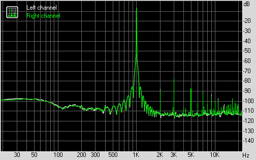

| Left | Right | |
| IMD + Noise, % | +0.1263 | +0.2991 |
| IMD + Noise (A-weighted), % | +0.0459 | +0.0667 |

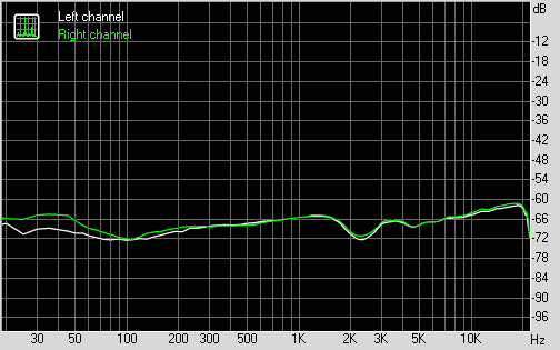

| Left | Right | |
| Crosstalk at 100 Hz, dB | -71 | -71 |
| Crosstalk at 1000 Hz, dB | -64 | -64 |
| Crosstalk at 10000 Hz, dB | -64 | -63 |

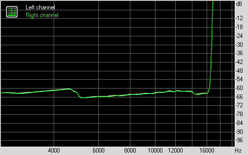

| Left | Right | |
| IMD + Noise at 5000 Hz, | 0.0584 | 0.0580 |
| IMD + Noise at 10000 Hz, | 0.0708 | 0.0678 |
| IMD + Noise at 15000 Hz, | 0.0660 | 0.0621 |
